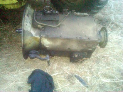

Allisons can have SAE 2 or 3. some 545s came with both, both md3060s and 643s came with 2s . I have a spicer 6352 5 speed direct 5th and 7.32:1 1st. it is SAE2 and will splint right into a clutch setup that had any spicer or clark behind it. And this you will never break.$400.
