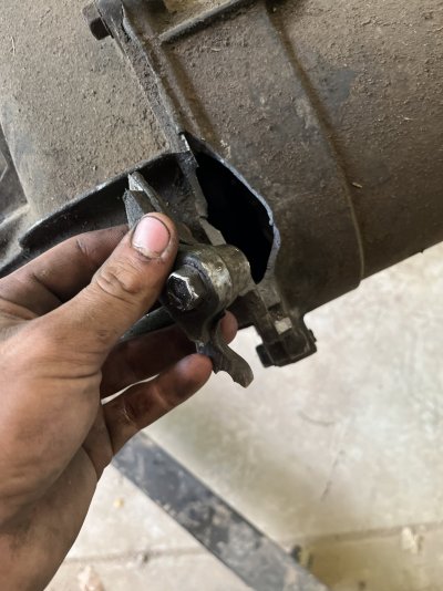

Not so minty… crack actually goes around to make a hole with the chunk still there… big sad…

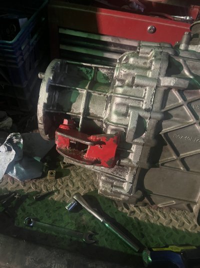

Sooo… I have this… thing… It was attached to my four-wheel-drive ZF5 before my friend rebuilt it, but neither of us can remember how it goes on, or what it is for, or anything about it. It appears homemade. I kinda wanna put it back where it was before the transmission got rebuilt, but neither of us could remember where it goes…

I figured out what it is. It is a brace that bolts to the case and goes where one of the mounting ears is broken. I sent a picture, but it said it was awaiting moderator approval. Probably because of its shape, and it’s in my hand in the picture. Lol. I will send a picture of it on the transmission in a moment.

As you can see, it sits up above the mounting ear. It will probably require a pretty long bolt, but I think it’ll work.

It appears that I will have to attach the transmission mount to the transmission before installing it in the truck. That doesn’t seem like a big deal, I plan to install the engine and transmission at the same time, and the transfer case afterwards. Er, whichever transfer case I find that works. Probably should not use the original one since it has a hole in it. Although it has already has JB Weld on it. As you can see, that is a fix all. I should just JB Weld the chunk back to the hole. That sounds like something that a Chrysler engineer would do. Even I’m not that low.

Rather than using that brace, maybe I should just get a longer bolt and put a big washer and a nut on top of that broken ear. The brace looks like it would give better support, but might be a pain.
