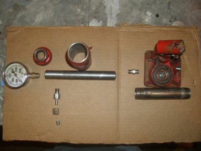

Made a version like this with o-ring plugs. Got the same comments about the cap. Did a second version where the plug and jack has been tapped for 1/8 pipe threads and a hydraulic union connects them. Would have liked to eliminate the whole reservoir and cylinder, but just was not a decent way to plug the tiny hole and supply test fluid to the pump.
