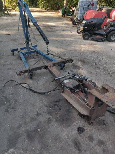

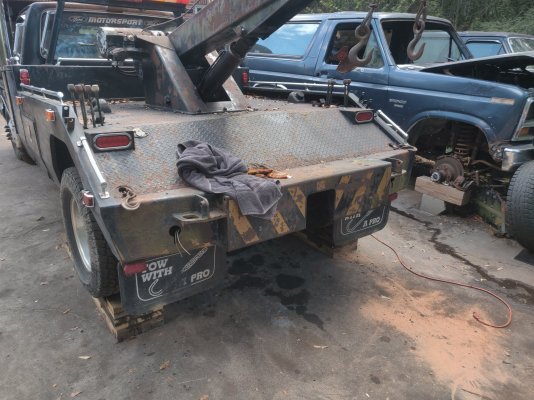

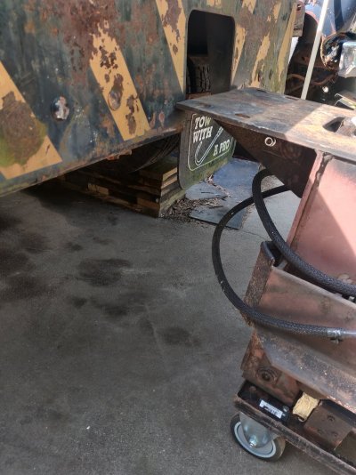

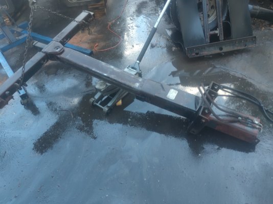

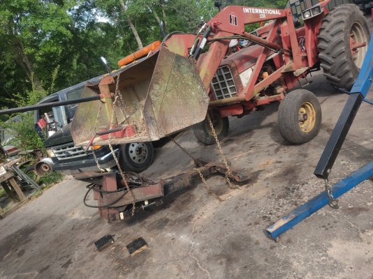

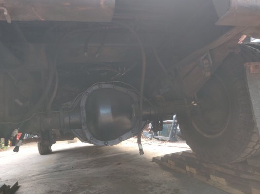

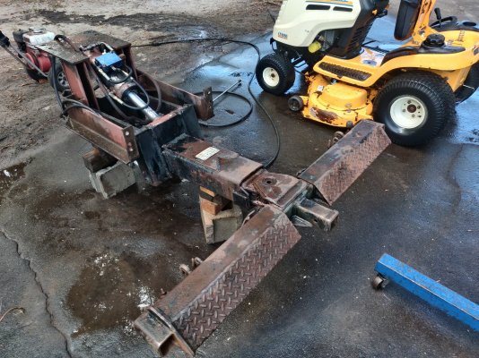

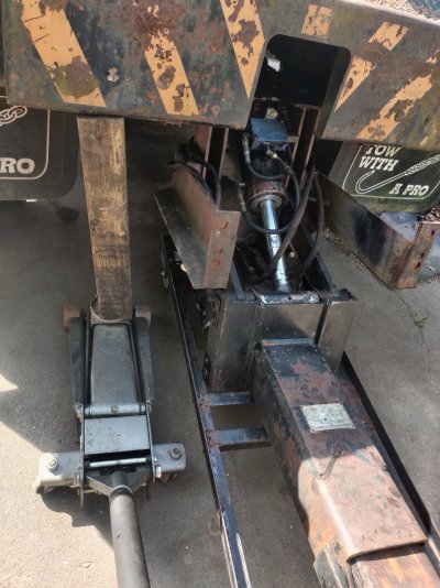

Ahhhh....... unemployment bliss........ well kinda, I quit FedEx about a month ago and have been doing the "fix it stuff" guy/used lawnmower salesman thing. So I dropped the insurance on my tow truck to work on it for a while. The wheel lift gave up the ghost several months ago and all I've had is funtional winches back there.

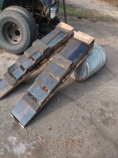

I built some hoss daddy wheel ramps to get the tow body up so as to have some clearance to remove the wheel lift. Removing the wheel lift wasn't too bad, I used the engine hoist....... and gravity.
I'm posting a picture of the undercarriage so you can wonder like I do; how does all that wheel lift fit under there???

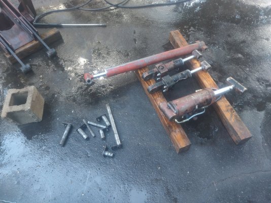

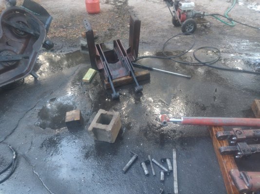

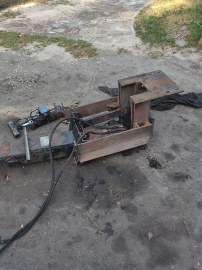

This is the pressure washed parts and pieces. Im posting these pictures so that you can wonder with me: how does all this go back together??? Oh yeah, and here's my 89 ultra that I've spent too much time working on lately.......ooooooo......ahhhhhhhh......

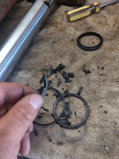

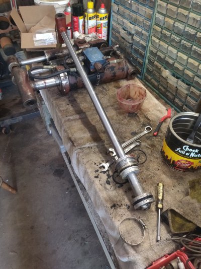

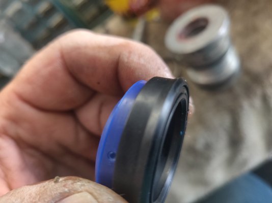

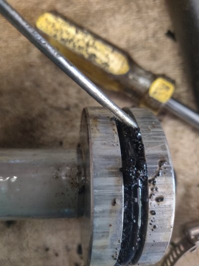

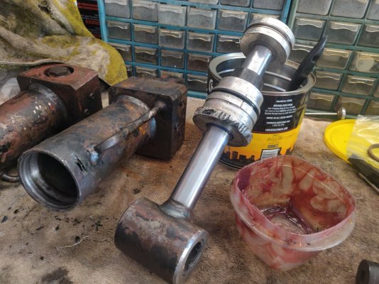

I finally got seals for the wheel lift cylinders! Almost $300 for a bunch of 0 rings and such....... crazy. They didn't even use a gun!
Anyway, I replaced all the disentigrating rubber and have it back together. I really don't know how some of these seals actually held up a hay trailer going down the road!

The fun part was fighting this steel puzzle back together.

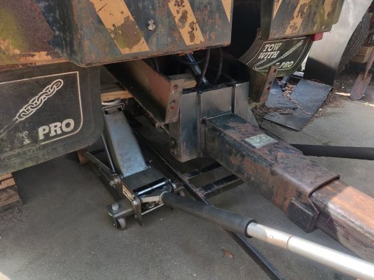

The hard/scary part was the "struggle for life" moments of getting the monstrosity back under there and getting a bolt started! I had this little cart thing I got out of a junk pile that was just the right size for it to sit on and roll around. I had to jack the bed up to clear the main mounting plate. Got er dun.
I got a couple things to come up with to fire it off and move it again. Hopefully.....Lord willing, that'll go down in a week or two.
