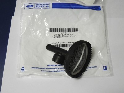

338
Just get the regular pickup called the shower head. Set er on the bottom and suck her dry. See the little feet all the way around, they keep out junk and enough fuel passes to run a 10L engine.
Never seen or heard of baffles or a sump in a fuel tank.

Guys, remember, Greg50HO's IDI is sitting on an 06 6.0 Chassis, which means the Excursion tank is a drop in.....
I know the 6.0 Excursion use a sender with the same Ohm range as the 87+ trucks and has as "Showerhead" (don't know if it is made of the same stuff, but it is a very similar design. If you look at the outside, bottom of the tank, there is a square bumpout in the center bottom of the tank. This is where the sender/showerhead sits.

I don't have a bump (although I'll probably make one) and I don't have a showerhead. I have plastic soupcan sort of thing that held the fuel pump and still holds gauge. the soupcan attaches to the top of the sending unit with plastic flex lines.
I'd love to have a bump and showerhead, I guess I bought the "wrong" tank. I haven't made any progress on it yet, ups brought my new headlights and relay kit so that's up next.

the ford dealer reamed me to the tune of 50$ for a showerhead when I ordered it today.
I didn't expect it to be so much
