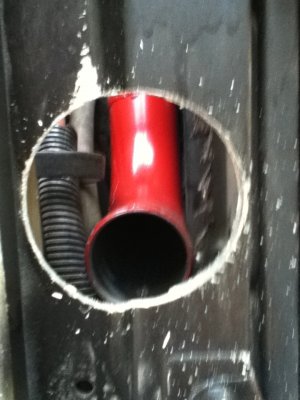

ok guys so i FINALLY got started on my intercooler install today
got the plumbing run and all just need to mount up the acual intercooler
but i have one quick question before i go and cut somthin in the wrong spot
the hood latch support runnin down the middle where exatlly do i cut that??
do i just take the whole thing off or what??:dunno

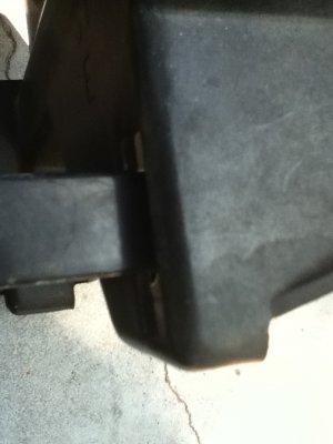

also when you put your grill back on..snap some pics for me..

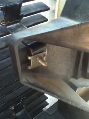

just how you mounted it.. i feel mine is mounted wrong and it sticks out too far. just snap as many as you can :thumbsup:

its a pretty easy mout just 4 screws and a adjust before u tighten

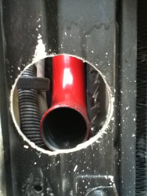

Ididriver
Mar 25, 2011
1,222
Panama city beach
ok so ive gotten alilttle bit more done today but not much

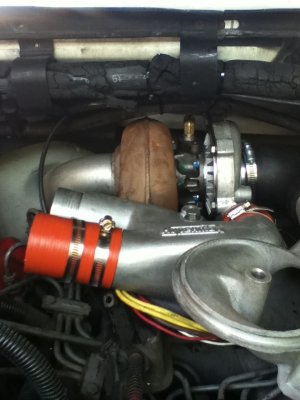

heres the intake hat and 3 in hole for intercooler piping
and for alienturtle theres a few of how the grill is mounted
anybody know how to mount the brackets the hypermax kit comes with it says drill but then how do i get the clip on the other side:dunno:dunno
