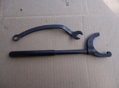

Got my pump all ready to take out except i cant seem to get a regular 9/16 open end wrench on the bottom two bolts. Any one know a handy tool or way that gets these out. Thanks.
This is the wrench that is in the factory tool kit. Before I had this I used a curved obstruction wrench for starter motors, and thinned out the end with a grinder.
