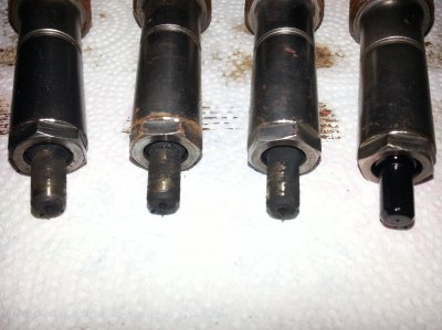

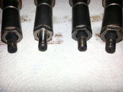

Decided to peak at the injectors tonight to see what they could tell me. Pic on the left is driver side. Pic on the right is passenger side. As you can see, I had one wet one on the ds and one clean on the ps. The rest where all the same.

Could just be me, but the wet one seems like something is wrong with the pintle. Could be ******* fuel.

Well that's the last time I buy reman'd injectors. Luckily I hadn't sent back my original injectors which were fine. I was just replacing them while in there replacing my return lines. I did however, disassemble them and put them in my sonic cleaner. Took a test drive today and shes good to go so far. No smoke and a clean idle. I'll check the timing next but so far so good. Swapped in some new glow plugs whaile I was in there as well. One of the gp's was so deteriorated my 3/8 socket was to big for it and no matter what I did I couldn't keep it from snapping off flush with the head. But that's for another thread:rolleyes: Thanks to everyone for your help and input.
