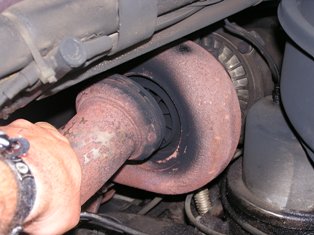

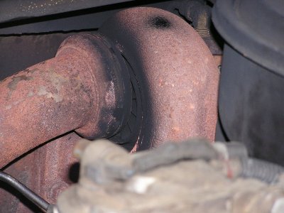

374
OK. When I read this...
my exhaust (i think it is the exhaust) has come off the turbo housing and Know their is no boost from the turbo.
I'm very confused. Let's stop right here and find out what has come off, and maybe get a picture of it. Because there is a very big difference between the down pipe, and the up pipe(s), which by the way, it would help to know if this is the pulse turbo or the older style. If the down pipe has come off, and you have no boost, then you have two problems, and if the downpipe came off because your housing cracked, you may have very serious problems.

it is a pulse turbo. heir are some pictures of the turbo

well it stopped raining finnally so i was abel to get under the truck and see that the exhaust broke under the cab. i cant believe that is all that holds the downpipe up against the turbo or am i missing something like gasket or something else.next question is can i run the truck back and forth to work (50 mile rtp) or is that too much.
I don't suggest driving it unless you like a) the sooty exhaust b) you have full coverage insurance due to the heat from the exhaust starting a fire in your engine compartment. Depending on where the break is, the downpipe meeting up to the turbo needs to fit snugly and direct the hot exhaust out of the engine compartment or you will have a real problem on your hands.
