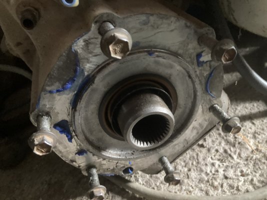

another Thing, if you install a transfer case onto the E4OD, does one need a new paper joint or something like it in between the both?
(don't mind, someone used some silicone)

It's too bad you didn't get the latest updates in there. I would have insisted on seeing the internals before they put it back together (planetary carriers, center support bearing, sun shell are all necessary updates, IMO). However, if you keep the engine stock, you should get a decent life out of the transmission. These upgrades would have also increased the cost of the overhaul, and it sounds like you were on a budget, so there is an advantage in keeping it 1989 spec.
Did you at least get an upgraded converter to prevent the same failure from happening again?
