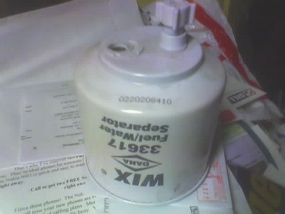

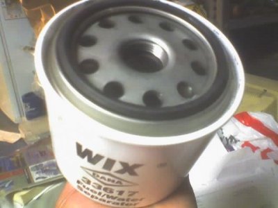

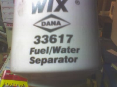

hee hee hee,I am a bottomless pit of information(mostly useless at that)....and if I don't know something,I am good at finding out on the net in about 30 seconds......Does that make me a Geek?!??
Oh,as for the name of the above item......It is just called a Fuel Filter(with built in water separator).When I got mine for the E(which DUHHHH,I found a brand new one after I got back home.....in the back seat!) I just said gimme a Fuel filter for a 1991 F350 with a 7.3L......they asked with or without drain and sensor....I just said with drain.And they then handed me the filter.
lookie...
