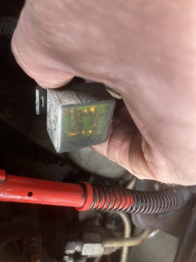

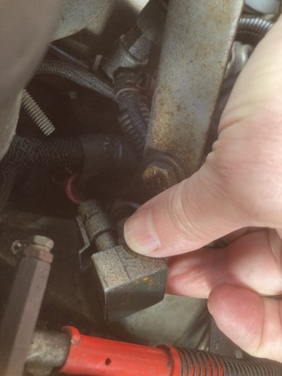

And while we're at it, someone know what this might be?

Bart F-350
