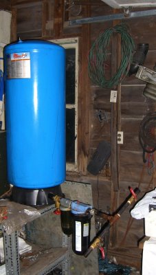

i dump my oil into an old well expansion tank that the rubber bladder failed on. i cut a hole in the top of the tank and it has pipe fittings off the bottom to feed my filters. my first filter is a 10 mic goldenrod filter
http://www.northerntool.com/webapp/wcs/stores/servlet/product_6970_910810_910810
then my second filter is a 1 mic water filter like mentioned
http://www.acehardware.com/product/...filter&parentPage=search&searchId=23741022213
i then have a 1/4 turn valve before and after the filters to stop the flow when not in use. right now i just let gravity do its thing but i bought some parts to hook my compresor up (with a regulator:D ) to speed up filtering. even just a couple lbs of air signifcantly speeds things up.

here is a pic of the simple set up i use, i was thinking i could direct the oil into two containers but really found it unnecessary. once i add some fitting to the top to put in some regulated air pressure it can filter allot quickly.

That is :thumbsup: INGENIOUS;Sweet .
I am gonna dig up the old tank that someone left at the shop a few months ago and follow your lead; I just hope that the scrap-iron pirates haven't beat me to it.
Are you using a common string-wound filter, or a pleated one ??
I have a bunch of very old brand-new pleated ones, still in the box, that I have been hesitant to use in my drinking-water filters, on account of where I got them; I wouldn't be afraid to use them for oil/fuel.
Also, some kind of heat source, like maybe a water-heater blanket, or one of those small electric throws, or maybe even heat-tape, or just mount the tank directly above the shop stove, would thin the oil for free-er flow.
That set-up sure beats the "can't do nothing else in the shop" set-up that I have been using.

On closer inspection, I had a small brain-storm :
An air-tank, from an air-brake application, would be even better than the old well-tank, as it would never have had the diaphragm inside it, nor all the rust and minerals associated with well-water.
Also, most air-brake tanks are blessed with dozens of NPT-threaded ports.
That is a good idea but the bladder takes up over half the space so must rust is at the bottom? but I'd say there might not be much in there? I'm going with that well tank idea too! i'll post as soon as i can.

thanks, the first filter is pleated but the second one was spiral wound, like it said they were the the standard ones that go with the housings. i honestly don't know a ton about them, i am actually following the lead of some people who said they used them. i did want the maximum filtering ability though. heat would really help flow the oil much better i am sure. in its current set up the flow is barely more than a solid stream if that. that will change very quickly once i add some fittings to pressurize the tank.
i did pull the rubber bladder out which took me about an hour and was slimy and nasty. hey is was free. i did cut out and leave the very bottom of the bladder where it is shaped like an o-ring to seal the bottom where it bolts on. i then pressure washed the inside to clean the rest up. there is some rust on the inside but i figured it wouldn't be a problem behind the filters and once it was covered in oil shouldent be a problem at all.
i am sure there could be better tanks but i saw this one at the right time laying out.
