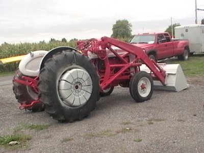

No ten minute job, gotta remove the brush guard 1st. Damn, now it's raining. Gonna pickup the backend and shove it out of the way with this.

Well at least you had something that was able to move the truck. Heres hoping its a simple job to get the hood open...
