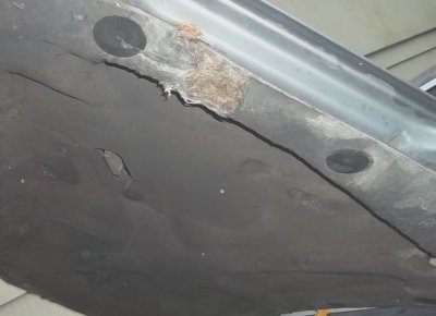

1) the clips go like this around the hood and if you look carefully you will see an X pattern across the middle of the hood. Clips go there too but mine are missing. The damage to the insulation was from an over-sized marine battery with the negative stud terminal sticking up and contacting the hood (installed by previous owner). You can see a dent in the metal from it. This caused a spooky electrical mystery: full voltage in the truck when BOTH neg. battery cables were disconnected. It also caused the hood not to close properly and I dented a corner of the hood trying to get it aligned. I have a good 92 hood with insulation to replace this one- again the X across center also gets clips.

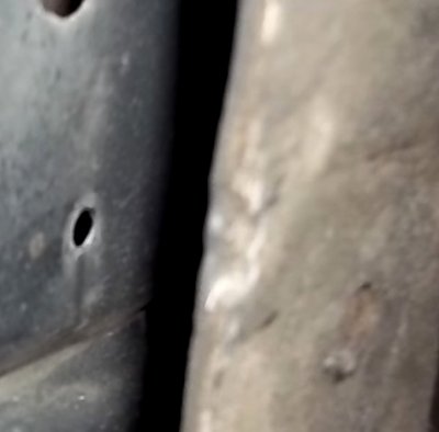

Next: Close up of missing clip and hole which is 1/8 inch. The original old clips didn't hold, new GM clips didn't hold and I have about 4-5 like this right now plus the missing clips at the X.

I just went out and took a couple of pictures of my 87 which should be identical to your 89.
I used an inside micrometer in the holes and on my truck they are 1/8 inch (3.175mm).
