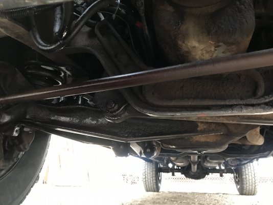

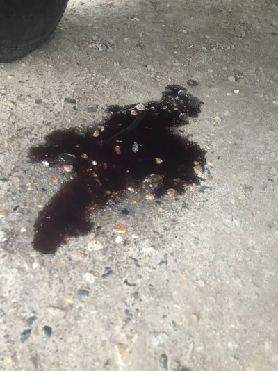

I have a major tranny leak I filled it up walked inside to wash my hand and came back to this
It’s every where in the front im thinking maybe trans cooler lines?
Any ideas on source
happy to provide more info if needed

I would suspect the rubber lines are bad (hard, cracked). It's hard to tell from a picture, but your transmission fluid looks like it needs a flush. At least a complete change including the torque convertor. It doesn't look like a bright red color.

What are you running in your PS pump? Is it The same color as the oil on the ground? Looks like it could be a ps line.
Thoughts
1) Check your Tranny and PS fluid levels? If PS is low fill it up.
2) Buy a bottle of simple green degreaser.
3) Go to one of those coin Car washes with the spray guns. Or park on your lawn.
4) Spray the simple green on everything oily.
5) Pressure wash it all off real good.
6) Let it drip dry/dry.
7) Put some cardboard down. Turn steering back and forth in park at 1200 rpm, lightly lock at full left and right. Give it a couple minutes and see if leaking. If yes confirm the tranny cooler lines are not as well. Both could be if you ran something over.
8) PS lines are not leaking drive for 1/4 check for a tranny cooler line leak. Repeat and see if you can find the leak.
Let us know what you find.

It does leak power steering but it’s amber cooler not pink I’ll have to check the other things later as it’s stuck at work

Looking at it closer it is really wet on the passenger side more so than the drivers side. So likely a tranny cooler rubber hose line. If you have a secondary air cooled tranny cooler, could be the lines to or from it or the actual cooler. Once you degrease your front end it should be easy to see where it is coming from.
I would replace all the rubber lines and clamps if any are leaking. Then you bought 8-10 years with out another hose leak.

I was at work and I was just idling walked inside for one minute came out to a drained transmission I’m thankful I wasn’t driving when it happened

The engine cross member looks dry, so not likely the powersteering circuit. Most likely one of the rubber hoses for the transmission cooler, as others have noted. It seems to be dripping from above the tie-rod so that narrows it down pretty well. Look next to the frame rail where the cooler lines pass to the front of the rad support. Also check connections to the auxiliary coolers, if equipped.
