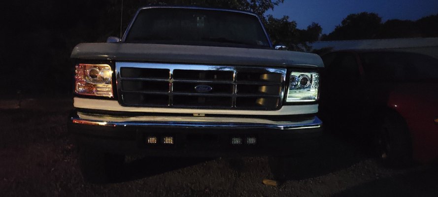

RockAuto replacement housings, and Easy Eagle LEDs from Amazon. Very, very happy.

How do they work with the stock housings? I used a set in my old audi and they just blinded oncoming traffic. I currently have relayed headlights with higher wattage bulbs.
I’ve been really happy. The low beams stay really low, but still spread wide, and the high beams light everything up pretty well. If I can remember, I’ll get a couple pics of the lights later when it gets dark.
TNBrett
Oct 24, 2020
748
669
Middle Tennessee
Ok, so this is facing my shop. The driveway slopes up to the shop a bit here, so it makes it look like they’re angled up higher than they are.
Low beams
High Beams
These are pointed down the driveway towards the road. I opened the door to take the pics, so you wouldn’t have to look through my dirty windshield.
Low beams
High Beams
it’s well over 200 yards to the tree line across the road.

Wow, that is a huge difference from mine.
They are TYC I believe. I’ve been impressed with their quality on other vehicles as well. They’re about $40 for the pair.
Ah, do you know if there is a difference between F350 headlights and F-Superduty headlights? I assumed there wasnt but TYC isnt listed for the superduty, only shows a Dorman part#. Although, I am assuming its the LED bulbs that make the difference rather than the housing.

That must be an error on Rockauto’s part. If you look in the descriptions the TYC and Dorman both list the same Ford part #’s as cross over. That seems like corroboration that they are the same between F-super and F350. But yes I think the LED’s make the difference.
