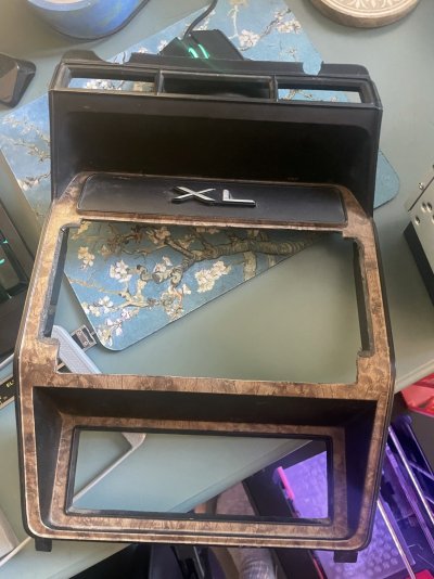

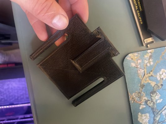

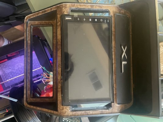

Double dins are totally possible, completely worth it and having a backup camera is awesome! You have to do some creative trimming and make a custom bezel but it’s completely doable. The only pta is you can’t use one with a CD player, they are to deep and with hit inner dash structurer.
