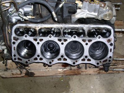

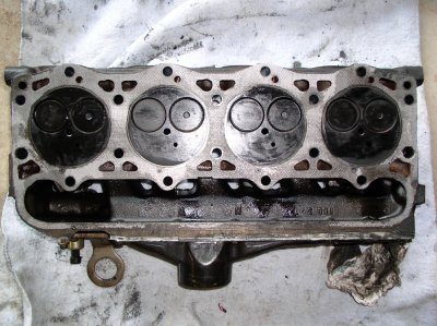

Although my problems are much more involved, we have 2 eras of 7.3's being dismantled in the same neighborhood!!
