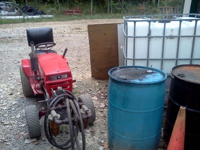

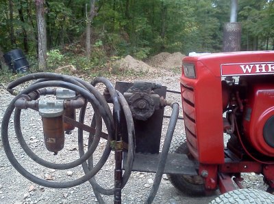

Heres my setup 330 gal tote I let settle then pump thru 2 golden rod filters into barrels and let settle again then pump it from barrels straight into trucks thru the 2 goldenrod filters again
