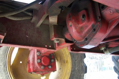

Saw these PORTAL boxes on a tractor and thought they would be nice to add to the knuckle of the axle? Hmmmm See they are already attached to a Dana axle of some sort....non steering axle though...so I wonder if one could just somehow mate em to the steering knuckle?

very nice!! never seen tehm portals before!! i think somthing can be made to work!

i wonder what the oil line is feeding the bottom of the housing? on of the problems with portal axles that steer is it GREATLY increases the stress on the knuckle joints.

The portals are not the axle I scored....I just happened to see them and it was something that I really thought interesting because they are on a Dana axle of some sorts. Was wondering if those Portals....could be made to work by bolting them onto the outer knuckle.....I know I am insane.....uh ya ha! Nice gear reduction and WAY better axle clearance with say 46" tyres or larger!
