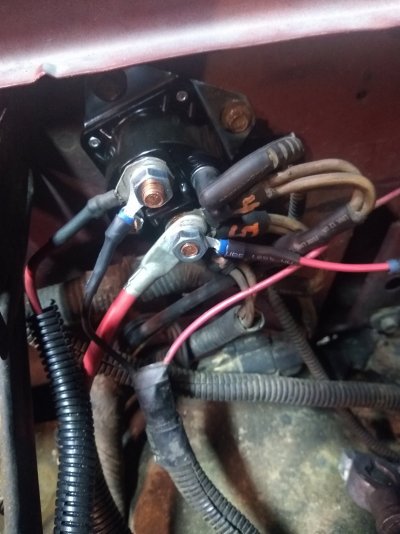

My friend saw a spark come from around the fender solenoid when I went to start.I replaced it with a one I had laying around to to check, still got no crank. I think I got a bad wire, I think it's the push button start wire the PO installed. Gana dig into that soon.

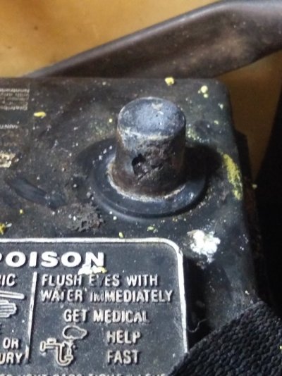

So I repaired some wiring that looked sketchy at the solenoid, put a new solenoid on and when I went to put the battery cables back on I noticed this. Maybe my batteries are junk. I think I need new ones anyway that terminal don't look good. The heavy pitted burnt one is a positive terminal on the drivers side. The other pic of a terminal is on the passenger side negative terminal.

4,163
4,716
While that wiring looks clean and really good, did you put the fusable links back in? Looks almost like normal wire in the picture.
everything is put back to original just cleaned up the wiring that needed It.
