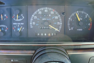

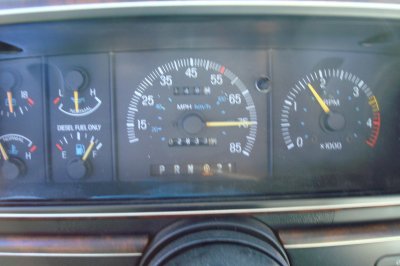

I do not have 4:10 gears or a ZF I have an E4OD and in double overdrive my final ratio is 1.96 per gear vendors books and charts. Doing 75 to 85 mph driving home from the 2009 rally I averaged 18.9 mpg. This is my rpm doing these speeds.

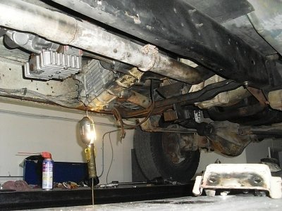

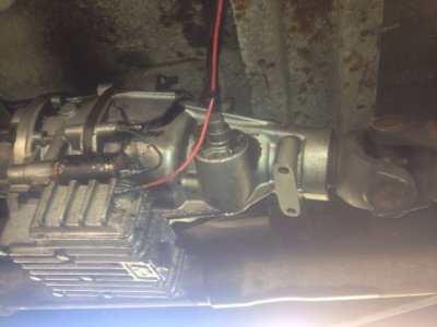

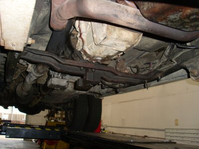

what is the legal speed limit in your state? in kali, it 65 in urban and 70-75 in rural. with my ZF5 and 4.10LS rear, 65 = 1800 rpm on the tach. any hint of a upward rise in the road, the speed will fall off immediately. where it is stable, is 2200 rpm but that meant I was running at 85 mph. in kali anything above 80 mph is a 2 point felony on your DL. when the GV was broken in half on a off road trip, I swaped it out and didn't bother looking for a replacement. need photo proof I ran a GV with a ZF5? see below.
