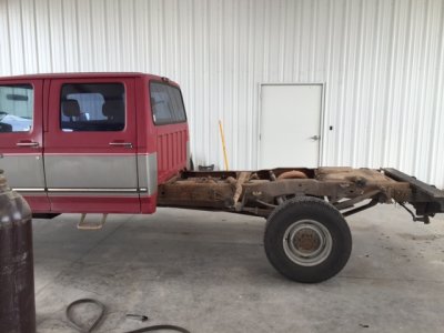

Bed is off! I only had to cut/grind 1 of the 8 bed bolts off & will have to deal with a small rats nest of wires from where 3 different trailer plugs were added at some point. Pulled both sender units to diagnose issues & found - Front tank) float is a round metal one which just so happened to be nearly full of diesel from a tiny hairline crack. I'm assuming its the showerhead? fell off of pick up tube as soon as I pulled sender unit out. Rear tank) Float is a plastic? rectangle unlike the front one but it was working fine. No shower head present at all.
I'm going to be draining the tanks so I can clean them out & look for the pieces that are MIA. In the meantime I want to go ahead & order new sender units & floats (Deleting the showerheads!) for both tanks since I've got everything this far. I've done a little looking on LMC's site & I can only find 1 sender unit for my year model. Are the front & rear senders the same? Or is there somewhere better to get these parts?

Some of the sending units are tough to find. Some people have resorted to rigging other units in place. The front and the rear sending units are different. I see you found a simple problem with your front unit. Ford or whoever designed these things had the great idea to "paint" the resistance material on a circuit board, and let the wiper arm in the unit rub on this to give the reading. Of course over time the "paint" wears off. In the old days they used a wire wound resistance unit.

TEST the sending units before replacing. If the sending unit had failed, most likely the gauge would read way past full (infinite resistance). More likely you just have a float that's sodden with fuel, and the float is available separately.
