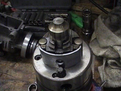

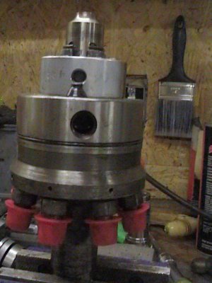

Best suggestion I can give is buy a snapon 5/32 allen wrench.Then get a 1/4 inch drive socket to fit this allen. Drive the socket down on the LONG end of the allen wrench. Of course it will be too long to fit inside the injection pump so cut it down carefully. I made mine about 1/8 to 3/16 inch longer than the depth of the fuel screw. Now use a 1/4 drive breaker bar and I guarantee you this will have the unbending torque to turn the screw either direction. I suggest backing off the screw before trying you increase the fuel by turning it in. Once this screw bottoms out running this pump can ruin it because the plunger not bottoms out and that's all this pump wrote.
338
The reason the fuel adjusting screw is so hard to turn, is that the screw head is pushing against the C ring that adjust the rollers out. Of course if the screw head breaks off, this is what will happen the first time the engine is run, it jams the rotor and shears the input shaft. If that happens, an easy fix, just a new IP install. :eek: :mad: :love:
Edit: I sent these pieces to Mel a few years back so he could show it at the rallies, don't know if he ever did tho.
