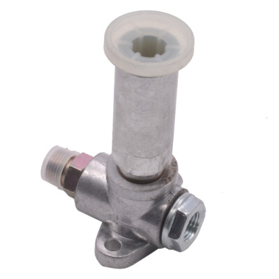

You can put a primer pump on the frame tied into the feed line to aid in getting fuel back to the filter, I did that on a topkick with a cat to make filter change easy.
That is not the same quality one I found for it, it looked more like this being all metal but cant find one like it.
Forget the metal one, use the Bosch Hand primer.
Nothing to unscrew and eventually leak.
The Bosch Pump, just push it up and down till
primed.
Use these on my Mercedes Diesels and the Datsun Diesel.
never ha a problem with them.
Be sure to buy the Bosch and not one of the chicom one`s
flooding the market.

I can't get my hands on such a pump and get it to work here. and after thinking about the circuit the return diesel has to go, I have the idea/feeling, that the return diesel flows without any pressure, via the "T" piece near the firewall right back into the tank.
So unless I make a mistake in my way of thinking, does such a pump have effect?
And what if I employ a universal anti retour valve there where the brass ducks beak valve used to sit?
15,051
14,150
This is right. There's suppose to be no pressure or almost no pressure in the return system.
If I am reading this correctly, and I may not be, it seems like you are putting the pump in the return lines somewhere. If so, that pump is supposed to go in the supply side, between the fuel tank and the engine.
