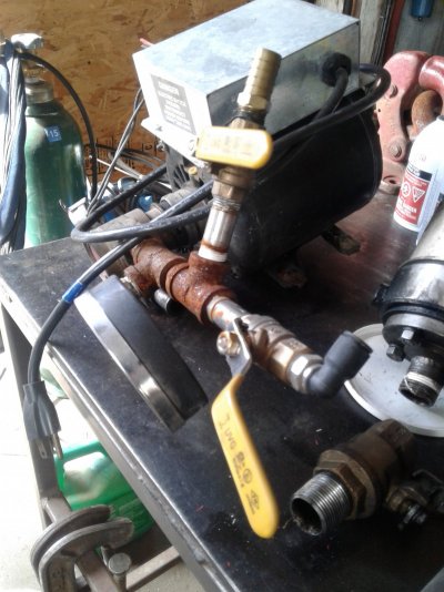

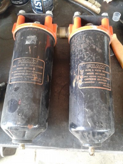

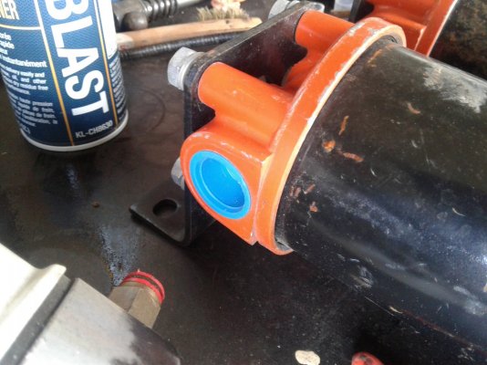

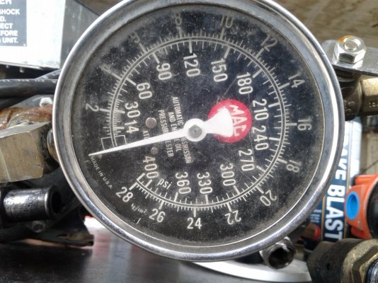

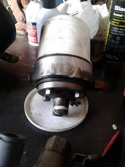

I made a deal on a centrafuge for motor oil, or for WVO , which was i had in mind mysystem has been basic filteration and a centrafug wuld ddo my system for cleaner fuel. So when i got there to pik it up, he had it in a box with ohe things. Well, the picks show what.
OlKoot
Jul 17, 2007
117
50
Creston Canada
I easil gave him 100$, and afer going through the parts, figured ut id made a good deal. A young guy, that go in deeper than he undestood i believe. Almost complete kit for waste oil cleaning, the otor being a 1/3 hp, a tad week, i have a 1/2 new motor that will workbetter. I hae some hyd hose too, for the pressure sise of thee pump. Te fiter, are 249$ a side, on ebay. Will see
