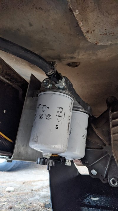

I deleted the entire filter bracket and went with an after market fuel filter bracket for under the truck. I deleted mine because it's a specialty fuel filter and it's prone to air leaks. This is what I have:

Oh wow, looks easy to work with but I live on the dirt roads in the woods and that would just get too easily gummed up under there. Are those just two of the same filters plumbed in-line?
Yes two of the same filters. I'm going to change the filter head though so I can run a 15 then 2 micron filters in a series for better filtration. It's not terrible and won't gum up. What do you think would gum up?
If you decide to stick to stock filter head, rather than trying to patch it up just get one of these: https://puredieselpower.com/ford/6.....3l-ford-idi-diesel-pdp-fuel-filter-head.html
I have not ordered one, but a friend did and strongly recommends it.
Sorry, I am not getting my notifications for some reason. I just meant that the dirt and mud would gum up the housing and outside of the filters. Probably wouldn't be too difficult to squirt down before changing the filters though.
What is the benefit to that filter head that you linked? (Edit: Nevermind, I didn't read the description!). I might look into this after I decide if I am going to keep the heater or sensor. Thanks!
