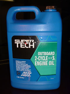

what is the additive needed for use in our trucks? I was talking with IDIeselman today and he told be to get some 2 stroke injection oil to run in my fuel system. I totally for got the name of the additive he told me to look for. Im getting the dreaded injector knock after buying some ultralowsulfer fuel today. I hope it is not a engine knock, it seems to go away right after idle. Thanks.
HammerDown
2,272
142
Glenolden Pa
Yep, after seeing the inside of a BB injector I can fully understand how adding (ashless) 2-stroke oil is a huge plus!
I go one oz per gallon. ;Sweet

ive got a case of Polaris injection oil left from when i used to have snowmobiles. Would that work? It is the standard injection oil.

Run some valvoline injection oil in it tongiht and it seems to be clearing up. doing it more eratic now. I hope it clears up soon. Maybe im just hearing things.

All of the Polaris 2 stroke stuff I've seen is ashless. I used to run Gold in my Trailboss 250 4x4 and had some left over when I sold it to pay for my Predator and ran it in my 86 with no problems.
