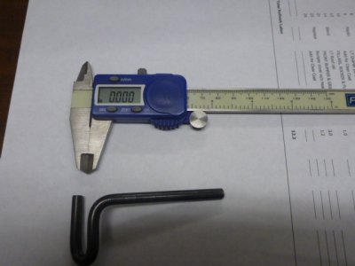

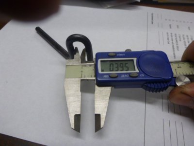

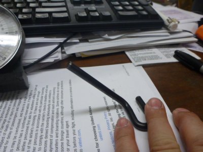

here are the measurements.

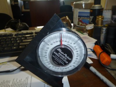

U Rock Calvin, thanks, Now I can attempt to get some tool steel, and bendy it all up into shape and about what angle would ya say that kinks off at looks bout 15 - 20 degrees to me...

Al... Thats the only demension I noticed was missing too but didn't want to poke fun..;Poke:angel:
