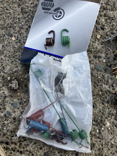

Here’s a picture of the part kit I have. The red springs here are the ones that popped off last time. Thought I was diligent about replacing things in the same orientation across brake jobs but things likely drifted a bit.
The red and green springs are mirror versions of each other to be explicit

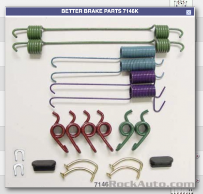

Last post on this: The thing that's most confusing to me about this is how the hardware kits come with 4x red springs and 2x green springs (my napa kit from above is the same). Just like this pic from a kit from rock auto
