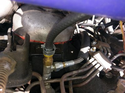

Ive run the cat filter above which I believe is 8psi and 44gph, and I eliminated the factory filter that Constsntly returns. Instead I added a poppet check valve set at 5psi to the fuel system high point that keeps 5psi on my injection pump at all times and returns only what's above 5psi, so it bleeds the air automatically and keeps back pressure on the ip. I have verified it to be 6psi and returning a steady stream with that pump at idle, didn't ever permanently mount a fuel pressure gauge to verify while driving but I'm sure it's keeping up with 5/16 stainless line the whole way

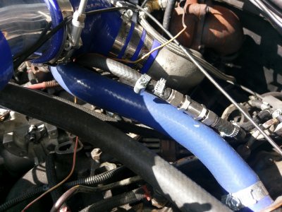

Here's some information on them, for 1/4" male NPT on both side the part number would be SS-CHM4-5 if it's 1/8" it'd be SS-CHM2-5. this will crack at around 5psi, mine opens at 6psi. This keeps a constant 6psi on your injection pump constantly returns fuel above that, constantly bleeds air (just like the factory filter) but rather than bleeding with a flow restriciton orifce only bleeds that which is above what the pump needs. I did run my front tank extremely low last week, i put 15 gallons back into my 19 gallon front, which is the lowest of ever running, i had to stop very quickly and the truck started sputtering, no dying, just a slight sputering and cleared up in about 5 seconds. I think i pulled some air in but it did its job bleeding it out and keeping the truck running. With my setup the factory filter has been deleted, the filters and pump are down below frame level and the IP is the highest point asside from the tee that connects to it with this fitting
https://www.swagelok.com/downloads/WebCatalogs/en/MS-01-176.PDF
Here is the comment i made on IDIots thread about it
