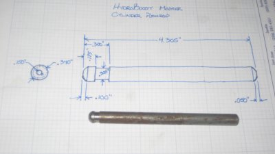

I finally got around to measuring the pushrod for the master cylinder, see pic below.

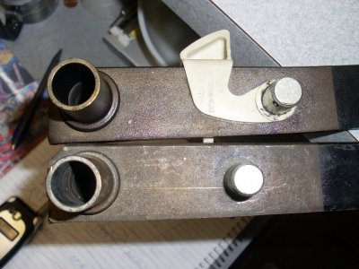

I went back to the JY this morning and robbed the brake pedal off of the same truck.
As near as I can tell (hard to measure with one of the brake pedals still in the truck), the brake pedal off of the F-Superduty has the pin located about 3/4" up higher than the standard F-series pedal. That is quite the difference.

Laying the two brake pedals next to each other on the floor and taking accurate measurements confirms the 3/4" difference in pin height.
The plastic bracket that hooks to the brake arm to actuate the vacuum switch for the cruise control must be different for the sup duty brake pedal; there's no way the original will work on the new pedal. The truck I robbed the hydroboosat from didn't have cruise control. A simple bracket could be made up to correct this, but just concreted my decision to ditch all the cruise control stuff on my truck as I've never used it anyway.

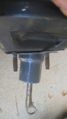

I did. All you need to do is trim down where the pedal stud goes around the plastic and glue the cancel block down. It's not mission critical and there is some adjustment for it too. I thought I had a pic of the after, but all I can find is the "before" shot. The pedal on top is the pre-hydro arm and the bottom one is the hydro arm. Mark the location on the hydro arm, trim the plastic block and glue it down. done!
The arms are also auto trans arms too.

If you get a chance, could you snap a picture of the after? I think I have a mental picture but not sure.
