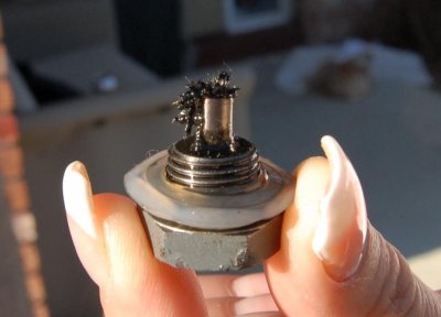

I drained the oil today and found a small amount of "curled" metal shavings attached to my magnetic drain plug, picture attached.
good news is that the noise was quieter after the oil change, but didn't go away.
I cut open the oil filter but not sure what you guys are suggesting I do now with a vise???
I can see inside the fins of the filter media and I'm not finding any additional metal parts within the fins of the old filter.
I've also drained all the old oil into a brand new walmart tupperware and I will check it with a magnet tomorrow.
It's not enough metal shavings to alarm me, does it alarm anyone else? I'm thinking this is normal for a refreshed engine?
Hopefully you can see the shavings on the plug, they are silver metal in color and are curled like a cedar wood whittler would create, tightly curled and only a single curl without a tail....Then there are smaller metal bits attached.
I'm wondering now if this BRAND NEW noise might be somewhat normal???
Why would a noise just popup if it's normal?

It would alarm me, I've never seen metal shavings come out of an oil pan.
Something definately isnt right.
gonecrazyi
Aug 27, 2008
3,276
florida
Thats a lot of shavings!
I dont really think youll know what there from until you open up the motor or get the oil analysis back.
