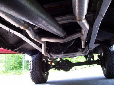

I'd say it would help some and am certain it takes away the cackle and quiets these motors alot. I have 3" duals on my truck and later added the H just behind theT-case and what a difference.
