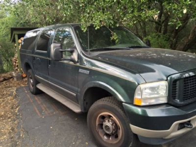

Well since I started it.... here we go.....
Mine:
1992 Pontiac Bonneville SE
1987 Ford Taurus Sedan - 4 banger 3 speed auto..... yes it was as bad as you think....
1992 Ford Festiva - Actually wasn't a bad little car...
1997 Mercury Sable Sedan
1994 Ford Taurus LX Sedan - 3.8L, a little sleeper racecar....
2000 Dodge Durango SLT Plus - 5.9L, all leather, just don't tow with it, the transmission will only last 1.5 camping seasons...
2002 Dodge Neon SE
2003 Ford Excursion Eddie Bauer
1998 Mercury Sable Wagon
1991 Wolksvagen Jetta
2000 P71 Crown Victoria
I currently own the Excursion, Jetta and P71
