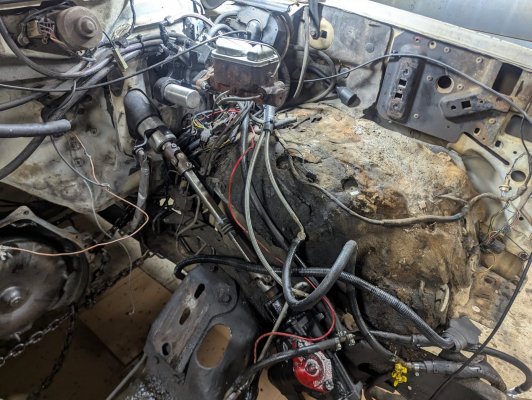

My factory firewall and fender insulation is deteriorated and a mouse nest on my 86 F350 6.9idi. Does anyone have recommendations for what to replace the engine compartment insulation with for fenders and firewall? I will be installing a turbo so feel I def need to add something to the trans tunnel.

That nasty looking k rap as shown in your picture, I Removed it and gave it the deep 6, and didn`t replace it with anything.

Looks better with it gone, and not sure it really did much as
far as sound. 30+ years of yuck gone.

Thanks for all the input guys. I'm planning to use DEI's form a shield on the trans tunnel. May put some Kilmat underneath it though.
I am thinking I will leave the fenders on uninsulated. The stuff that's there is just so nasty. Can add something later there.
