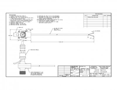

Here's where I am at currently - See the picture below.
This fits right in the 4r100 tailhousing, and drives a cable.
This van has both - one in the tailhousing and one in the axle.
