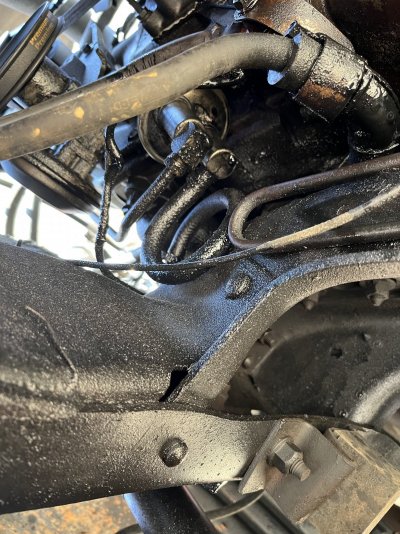

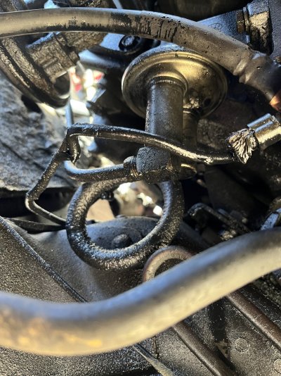

c. Here are some pics of the life pump. Looks like I have some fairly substantial leaks. Looks like I have some issues to address here.
JParson
Oct 24, 2021
17
18
Pearl, MS
Brings back memorys of when I first bought my IDI. Those lift pumps are cheap around $30. Just make sure you get the arm under the camshaft when you install it in the block. I recommend not installing it dry. Put some assembly lube on the arm so it is not dry on the cam when you start the truck.
