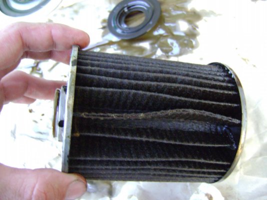

Here is the picture I had of the FL1A I cut open with a torn pleat. If you look at the right side of the picture you can see the base plate and where the glue mark is from where the pleat was from the factory before it tore and collapsed. Kinda hard to see but look for the V shaped mark in the glue. Picture is dated 2012 so that shows you how long this problem has been going on.
