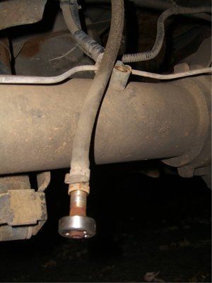

sorry for leading you astray i checked mine and it is 7/16 - 20, i imagine yours would be the same. not used to these big trucks yet, hope this helps in time.

Does that bolt have a hole through the center of it??
Your set-up doesn't really look like mine; but, after I get the thing cleaned up, it might be the same.
The one in the picture looks to screw in the top of the tube; whereas, mine was screwed in the rear side of the tube, at about the center from top to bottom.
Everyone should crawl under and check the vents and hoses, as they will stop up real quick, with mud-daubers and such.
Once stopped up, heat will create pressure, pushing lube out the seals.
Thanks for the pictures.

yes the bolt is hollow and it is screwed into the back side of the axle but on the upper side not in the middle. i just left the vent tube on the bolt holding everthing together because i was just checking the threads. i dont really plan on mudding a 4 door long bed but i agree from jeeping experiance not to get these things clogged and to run the vent hose up somewhere high.
