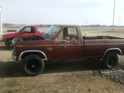

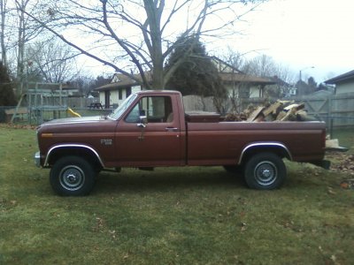

Sounds like that's what I will go with. Well after I get it on the road lol I have no time to work on it because it is two hours away from where I go to school! Money is always an issue as well lol! I think 285's will look good on it, the tires in the picture are 265's and they don't look that small. I can't decide if I like the hubcaps or just the black rims.

I have a empty set of outlaw II'2 that would be great on your truck if you want pm me. Because hub caps look bad IMHO
