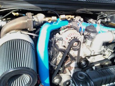

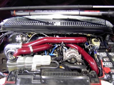

Here you go this is kind of what I had in mind but the side turbo would be lil bit more forward by the alternator. The intercooler tube would go around the other side. I'm trying to find a better pic.

This first pic with the Turbonetics turbos is exactly what I was thinking. The second pic from Empire Diesel is also cool.

Wmoguy, are those pictures of those compound setups similar to what you were thinking? Those are what I was talking about...
