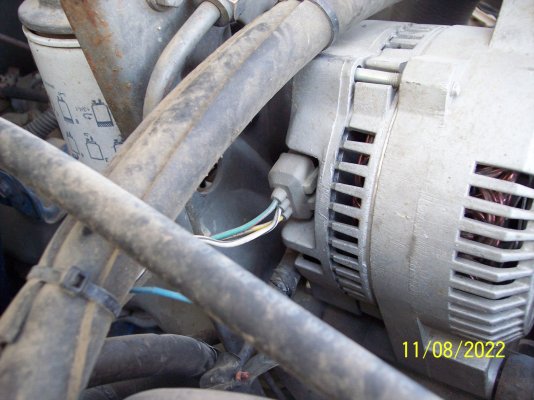

3G is a simple swap, even I didn't screw it up. Headlght relay upgrade is another almost necessary upgrade that should be done to these old trucks. I have some photos of the 3G swap. I'll dig them up and post for you.

No. It's a standard 3G alternator. The regulator is on the back side. I clipped the stock regulator wiring and wired into those instead of wiring like Catbird's picture shows. Either way it still gets the job done. If you like, I can get some pictures of the new alternator that I'm going to be putting on this week.
