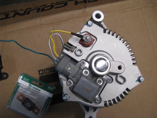

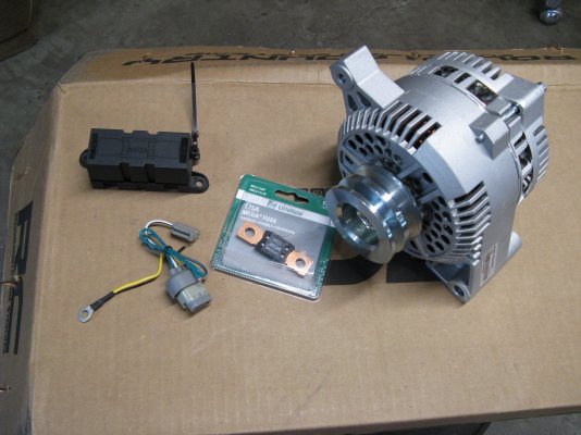

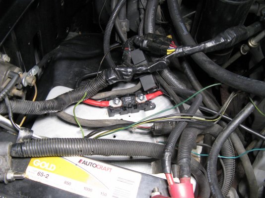

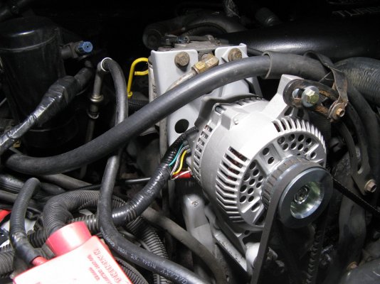

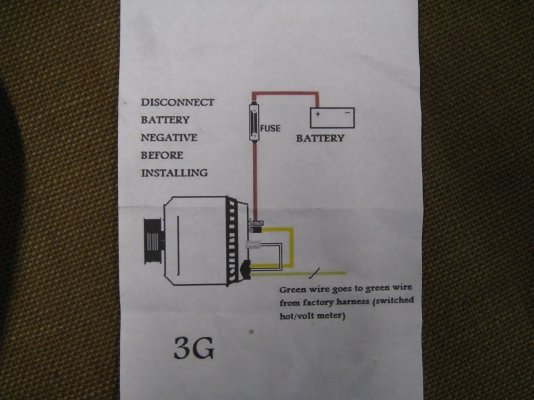

By the way, my truck did the exact same thing you described with the battery light flickering. Ended up being the plug on top of alt. Well that's all gone now with the 3G swap. See pics, hope they help.

I don't remember the green wire but I likely abandoned it. Great post @catbird7 !
I also used a resettable breaker instead of a bus fuse but it's all good.
Your truck flickered the bet light and OE volt gauge to the positive side?
So, that 3G alternator uses the OE mounting bracket etc or are modifications required?
