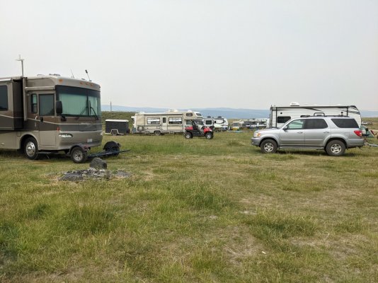

I'm over west of Grand Teton in Idaho. I was here exactly 4 years ago with the F250 but it's camper is just a shell so it lacks a bathroom, shower, etc. I stayed about 3 days, left to go somewhere close, then came back for a few more days. I'm gonna stay the full 10 days this time since my RV setup allows it, plus I carry an extra 23 gallons of water in jugs on top of the RV fresh tank. It gets crazy busy here on weekdays but it's not too noisy since people are out boating and fishing on the river. The water is very low this time though.
