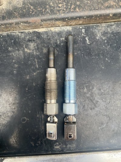

When I got home I pulled all the glow plugs out (autolites) almost every tip was swollen or cracked, cylinder 3 was even missing the entire end and who knows how long it has been like that. New motocraft glow plugs were put back in.
Should I pull the glow plug back out on cylinder 3 and put a borescope down the hole to check to make sure it’s not still in the precup or would it have broken up and been sent out the exhaust valve by now? Again truck ran great the entire 4 hour drive home with no smoke out the exhaust, good power on hills and the whole 9 yards. Even got 16 mpg cruising at 63 mph. Just trying to gauge how concerned I would be.

If nothing it happening I would not be concerned but it never hurts to be sure
personally I would check it out with a boroscope
15,051
14,150
Especially after a 4 hour drive. If you were going to have a problem, it would have already happened. Of course if you really want to use a bore scope, then go ahead and do it. I just don't think it will benefit you in any way.
