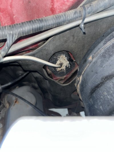

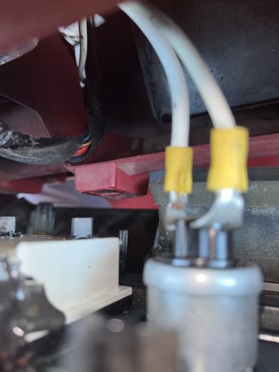

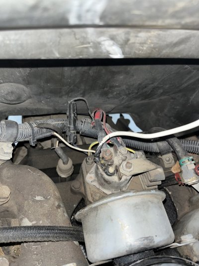

When I bought my truck, it came with manual glow plugs hooked to a push button on the dash. As I've driven the truck more, I've found that the connections to the button are unreliable, meaning that I have to push the button several times to engage the glow plugs. I Also want to use this space to mount a pyrometer gauge. Is is possible to convert my truck back to manual glow plugs? If so, What would that require? I've attached pictures to show the work of the previous owner.

Here's a link for the manual GP conversion, https://www.oilburners.net/articles/glowplugbypass.htm
Basically just swap the two white wires in the pics. The white wire that is taped off to the side should be attached to the small post on the relay and the larger gauge white wire tied off somewhere.
Personally I prefer the manual setup because it has at least one advantage over the factory setup and that is the ability to glow the plugs as long as needed even if there are dead glow plugs or broken wires in the GP harness. With the factory setup failed/failing glowplugs change the resistance in the circuit and the controller will cycle off before the plugs have fully heated. So on the one hand the factory setup acts as a diagnostic procedure for the GP system but it can lead to hard starts if there is a problem and it's not fixed immediately.

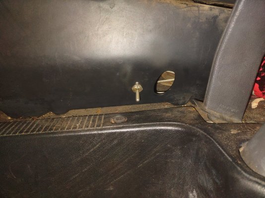

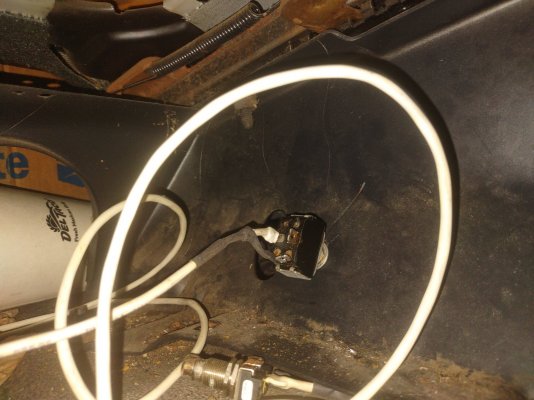

Below, I post two photos of what I did.
One is looking in through the open driver side door. Look for the bat-handle toggle switch. The other is an under-seat view. Its best wired then fastened in its mounting hole.
One of these days, I'll get the wire dressed prettier...there's already a hole for the seat belt nag switch that the previous owner had disconnected and I didn't want it either.
