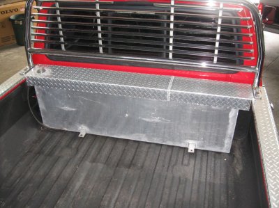

I picked up a small aluminum fuel tank today, Looks like about 28 gallon that will fit nicely between the tool box and the front of the box. I'll have to move my tool box back by about 7". It has an electric fuel pump inside that I installed and works good.
I think that I want to hook it up as a transfer tank to fill my front tank when needed. My question is how is the best way to get the fuel into the front tank? Splice it into the filler neck? "T" it into the return line?

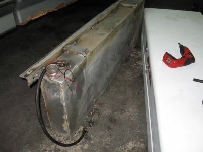

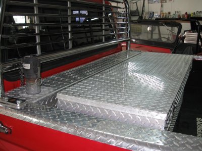

Here are a couple of pics of the tank, and there is a diamond plate that covers everything once it is installed.

Well I am getting the tank installed, I removed the tool box wich means removing the propane tank, air compresser, and all lines and wires that are associated with them. But my tool box had some seams busting off the end so I took it to my buddys welding shop and welded it back up.
I got the tank sitting and am ready to bolt it in, and drill the holes for the lines and wires. I am going to wire the in tank pump to a switch on the counsol, and plumb it into the filler neck. Sounds like the easiest way to make it functional, so thanks for all of the input on that!
Once it is installed and plumbed I will reinstall the tool box and all related accesseries.

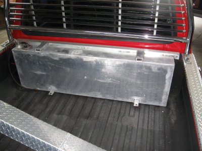

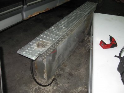

Here are some pics,...Not a bad setup for $60.00 hu,..?

You're killing me! Not bad! Not bad at all! You kill me with your "finds"! Looks awesome! You get alot for how little space it takes up! :thumbsup:
Thanks Eric, The little space thing is what I was looking for, It fits real nice.

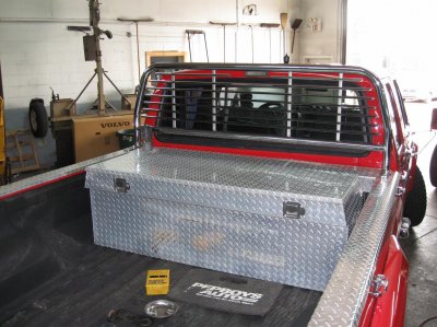

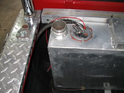

I got it bolted in and the tool box installed last night. Now I have to get everything wired up and installed.
