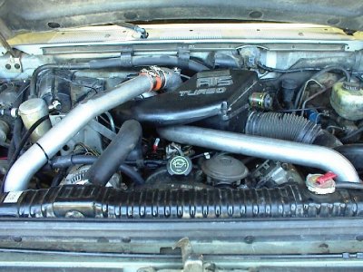

I am going to be eliminating my ATS airbox and put in a "ricer" intake pipe. In order to get a fairly straight shot at the turbo opening, I will be putting in a Eseries feul filter base assy and use the Fseries bracket for holding down the intake pipe. Eventually, I will be blasting a hole in the fender for the air intake tube so the truck can go play in "wading pool deep" water. stay tuned...;Sweet
oh yea...here's what the engine compartment looks like at the moment.

I don't see myself going to the intercooler on this truck. Another question is I'm not sure I want to go to a RDT. Is there any reason a longer hose couldn't be run from the CDR valve to the intake tube? Basically what the factory set up is, right? Calvin, will you have to move your fuel filter when you do the airfilter? Chris Binoeder did it on the Godzilla Jr. but that's such a great spot for the coolant filter (off the alt. bracket). I'm just kicking around ideas. I don't have the money for all this stuff right now anyway but when I do I want to have my battle plan ready to go.
